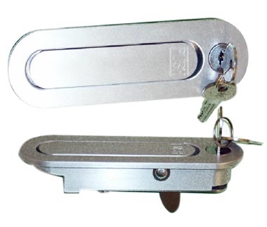

ArtFox 05-21-2008 04:28 AM
Flush Handles: Worth the effort?
Aircraft have flush door handles.
https://www.aircraftspruce.com/catalo...s/06-00830.jpg
Has anybody actually replaced a stock door handle and adapted the bodywork or produced some sort of clip on fairing to cover a handle?
These seem more flush than my Jetta IV pull handles but would need bodywork.
https://i16.ebayimg.com/03/i/03/12/59/0e_1_b.JPG
Finally, here is a true "flush handle"
https://luckymcgee.com/img/flushhandle.jpg
