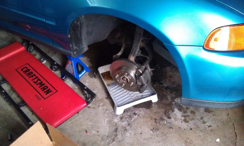

So, I rewired the entire car and replaced all of the suspension and brake with OEM replacement parts. All new gaskets, seals and hoses. Mounted new tires on the stock VX rims and sold the Integra wheels. Bought new injectors and did what I could to return this car back to stock form.
At some point this car had a K series engine swapped into it so the transmission mount to the body was missing and there was a hole cut into the floor for the shift box. So this warranted me buying a new welder to patch the hole and install the mount back onto the frame.
Excuse some of the pictures, its rather hard to take good quality pictures with your phone in a single car garage in subzero temperatures

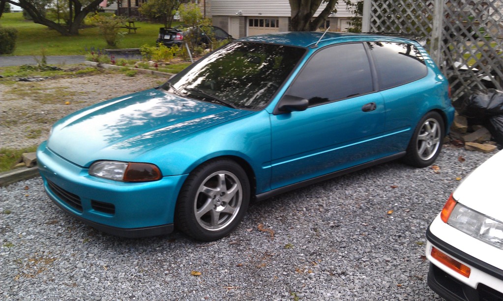

So I drove the car then like this for a few months before sending it to the body shop for some minor rust repair
Then, happy with my progress, fast forward about a year I began parting out my CRX and decided to try on the wheel onto the VX just for grins. They hurt the gas mileage pretty significantly so they only lasted about a week before selling them as well.
