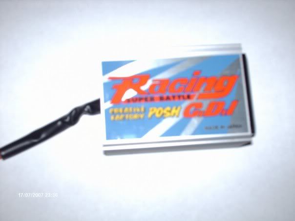

4. tune!!!!! A well tuned motorcycle will trumph a poorly tuned bike any day. Forgive me, I am unfamiliar with the honda valk. But, is it fuel injected? if so, a power commander with a very small fuel cut would help. It is probably not throttle by wire (which can be programed with a kit) if it's carbed, you could maybe get away with lowering the slide needles a touch to decrease acceleration gas used.
