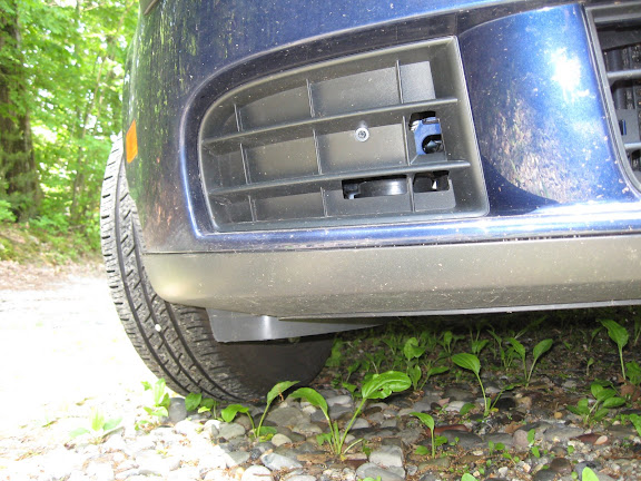

The little grilles in the bottom corners are called "fog grilles", and don't appear to have any function here. The passenger side one is blocked already, but still has the grille lattice sticking out enough to look like a grille:
I don't know why that ugly screw is right in the middle of it or what those few small holes are for.
The drivers' side is more open:

They do make OEM lights but I'm too cheap/broke and I'm not sure how much they would help aerodynamically. Here's what I'm thinking for a plan:
- Try blocking the fog grilles with something smooth, see what the effect is. If it's good, I'll have to see what I can do to smooth it without making it conspicuous. Maybe I could bring the fog grilles forward so they're flush with the front, and fill them in with rubber so it's mostly smooth but still looks like a grille.
