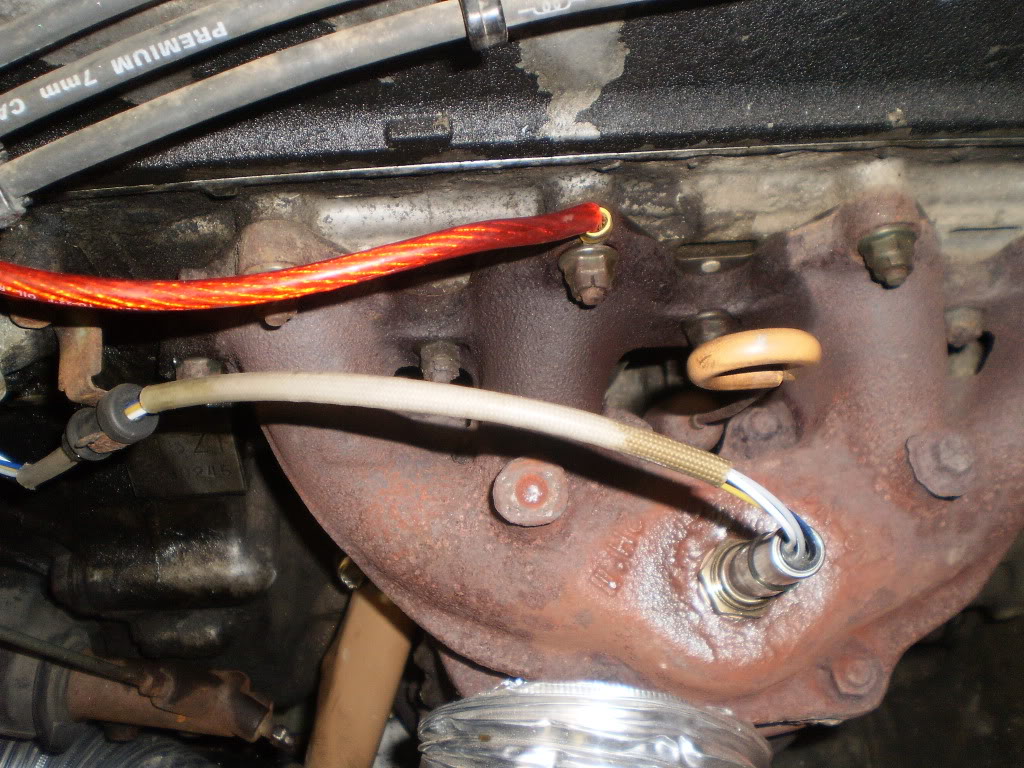

There is one more (or two) sensors you may not have considered and especially in this way.. The O2 sensor... It's possible that before you get this better fuel economy and more power, you're stuck in open loop mode, for what ever reason. So here is what I want you to do. I want you to first inspect your exhaust manifold/catalytic converter, see if there is any rust. Then take off your exhaust up to the point of the last o2 sensor. Then remove the O2 sensors and inspect where they screw in. If you can, take pictures of all the rust you see, the bolts that go into the block, the holes the O2 sensors screw in and maybe other stuff. Then get a stiff brush and remove all the rust you see in the threads where the O2 sensor screws in, the rust where the bolts go through the manifold and then into the block, the bolts themselves etc.
Why am I suggesting this almost unheard of suggestion? You might not be aware but the body of the O2 sensor, the part that screws into the manifold itself is actually used with the O2 sensor for getting signal, and or providing ground power. When I've had to test O2 sensors, I specifically had to hook up a probe to the body of the o2 sensor and to one of the wires to get any signal (at least with a 4 wire). So it's still conceivable to me that this still applies. Anyway my point is, because of the rust, this could be affecting the way the O2 sensor either heats up or sends signal to the ECU. So my solution is to ensure there is a good path of continuity from the O2 sensor all the way to ground. This means removing rust from where the O2 sensor screws in, on the part of the manifold where the bolts go through into the block and the bolts themselves. Since you live in Maine, it's very unlikely for you to NOT have rust which is why I make this suggestion.

Yes, indeed, the whole maniverter where the 02 sensor is housed is rusty. It's cast, so it's not going to rust off or anything, but it has a lot of surface rust. I will pull it tonight and clean it/where the manifold hooks to the block and the like. Additionally, I may try to find a way to ground the sensor body itself... not sure how just yet, but I'll put my mind to the grindstone.

Well, I did clean the maniverter hole with a wire brush drill attachment. I also attached a ground lead to a manifold bolt.
Here's a photo:

The initial road test seems promising. The car does appear to have a little less hesitation and get up and go when it is warmed up. (probably mostly in my head) I'll know more tomorrow during a 65 mile trip I have to make including some highway. I'll give an update.
It seems either the 02 grounding issue or the fuel filter might be the issue.
